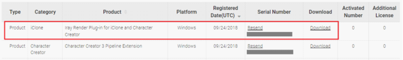

For Iray Plug-in Pre-order users:
With your Iray Plug-in serial in hand, you can download the program and activate it right away. Simply log into your Reallusion member account and find the Iray Plug-in record in the "Order" or "Registration" section.
