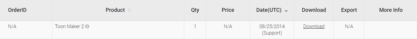

Download
Ref: https://www.reallusion.com/downloader/
Use the Universal Installer (Install.RLD) to apply content to the latest FULL version program like iClone 7/6 (Character Creator 3/2/1), CrazyTalk 8 or Cartoon/CrazyTalk Animator 4/3/2.
Whereas to apply content to legacy tool like CrazyTalk 7, CrazyTalk Animator 1 or iClone 4/previous version, ONLY select the old format Windows/Mac installer to download and install the content.
If you only own iClone 5, then ​after confirming the program compatibility​, ​​you may download and setup the Content Downloader program once;
whereas if you purchased the Mac program (CrazyTalk 8 or Cartoon/CrazyTalk Animator 4/3/2) from App Store, then please download and setup the Content Downloader program once, to install the Universal Installer (Install.RLD).
