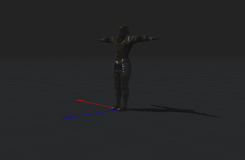

Difference gears and devices have varying X, Y, and Z settings in there native coordinate systems and may require different directional settings when setting the t-pose. The following is a list of facing directions for brand-specific devices:
Vicon: Any (adjustable)
Optitrack: +Z
Xsens: +X
Neuron/Neuron gloves: +Z
Leap Motion: +Z
Rokoko/Rokoko gloves: +Z
Vicon: All
Optitrack: +z
Xsens: +x
Neuron/Neuron Gloves: +z
Leap Motion: +z
Rokoko: +z
